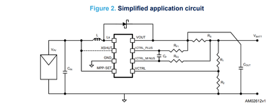

I'm trying to use the SPV1040T MPPT IC to boost up the 1.5V I'm getting from the Solar Panel to 3.8V. When I Power ON the MPPT IC its output just follows the Input and i don't see any chances of voltage getting boosted up. Is there anything wrong in the design attached? Please advise.
For now, I'm using the Lab power supply to power the MPPT IC, the O/P voltage is set to 1.5V, Current limit is set to 100mA.

from ds:
So connect the ictrl-xx to gnd, and xshut to PV+.
