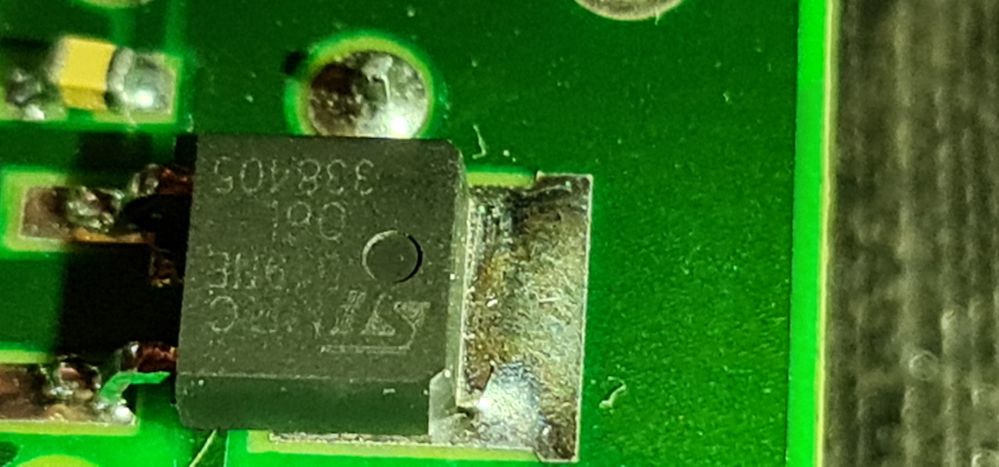

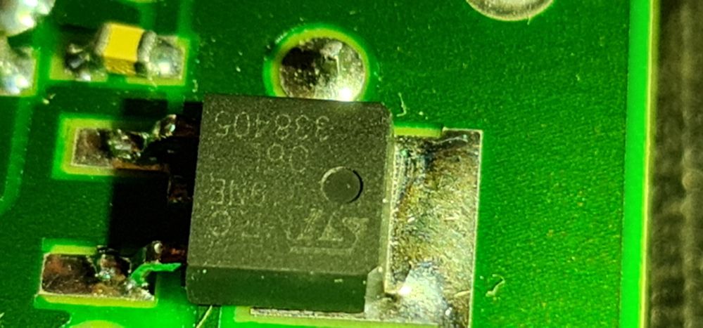

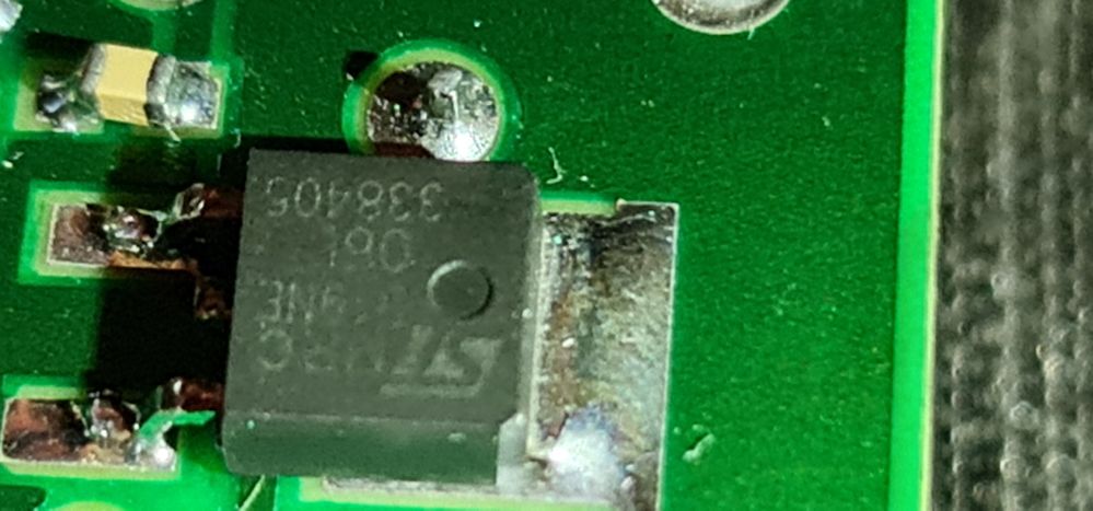

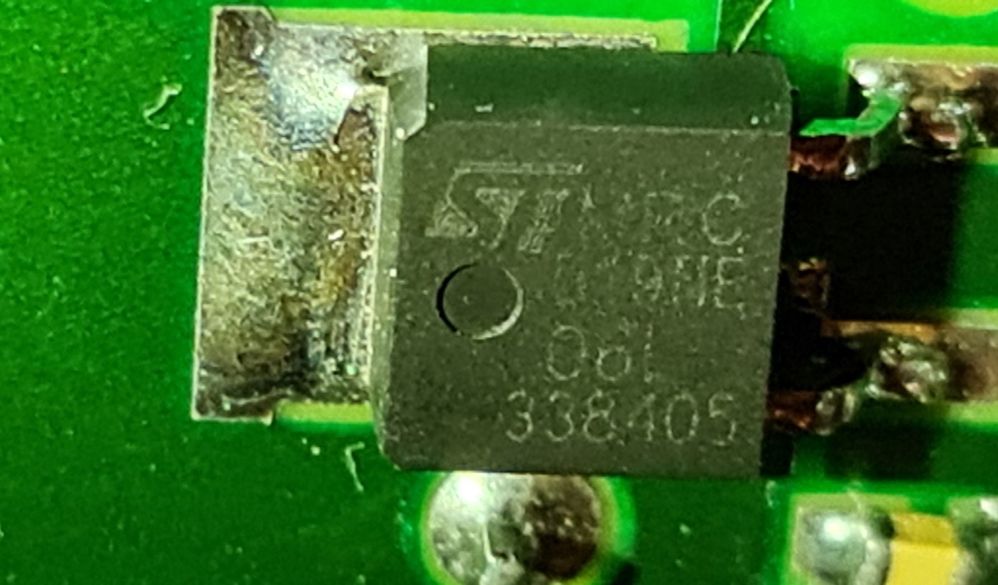

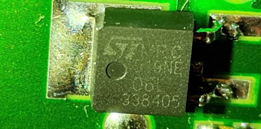

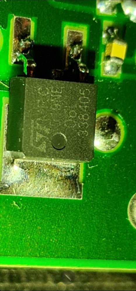

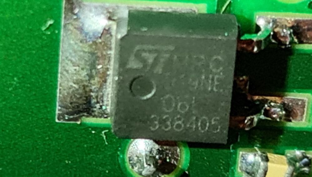

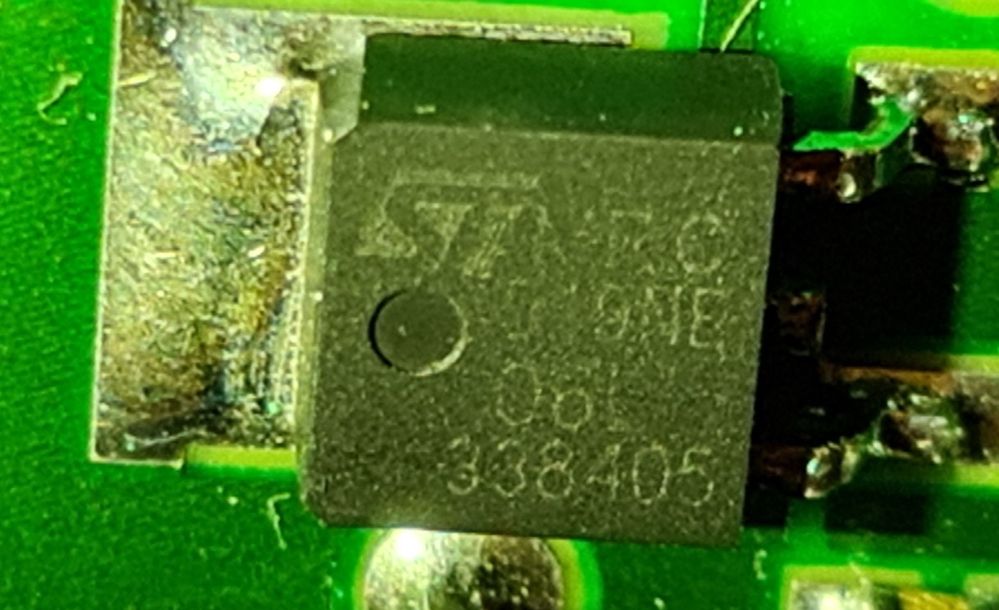

Here are pictures of the component I'm looking for.
This comes from a control board for a rear light (Led) from an Aston Martin DB9 - 2005.
There are 4 on the board and one of them is burnt.
I can not find this component in the trade and impossible to find an equivalent.

Rotating the pictures could help somehow. Writing down what you decipher would help more.
2021-10-27 5:27 AM
Thank you for your answer.
I can read only part of the reference :
MFC or NFC or MRC or NRC
19NE 06L 338405
2021-10-27 6:10 AM
the picture at https://www.ebay.com/itm/224227338361 match partial.

Hi Peter,
thank you very much for your answer.
Your informations are very complete and they will be very useful to me.
I will immediately order the component.
Best regards
