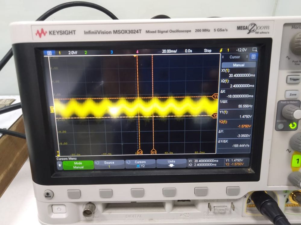

we need to see te code aswell, did you probed the inverter output with an oscilloscope?
Maybe is much much noisier and spikey than you expect. (specially with no load attached)

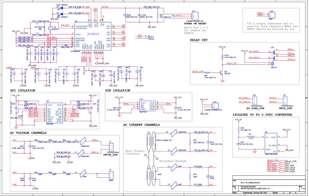

V factor = VREF * (1 + (R1 / R2)) / (AU * CALIB_V * DPOW)
= (1.18 * (1+ (810000/470))) / ( 2 * 0,875) = 116274,11
I factor = VREF / (AI * CALIB_I * DPOW * KSI * KINT )
= 1.18 / (2 * 0,875 * 0,00260 * 1) = 25934,06

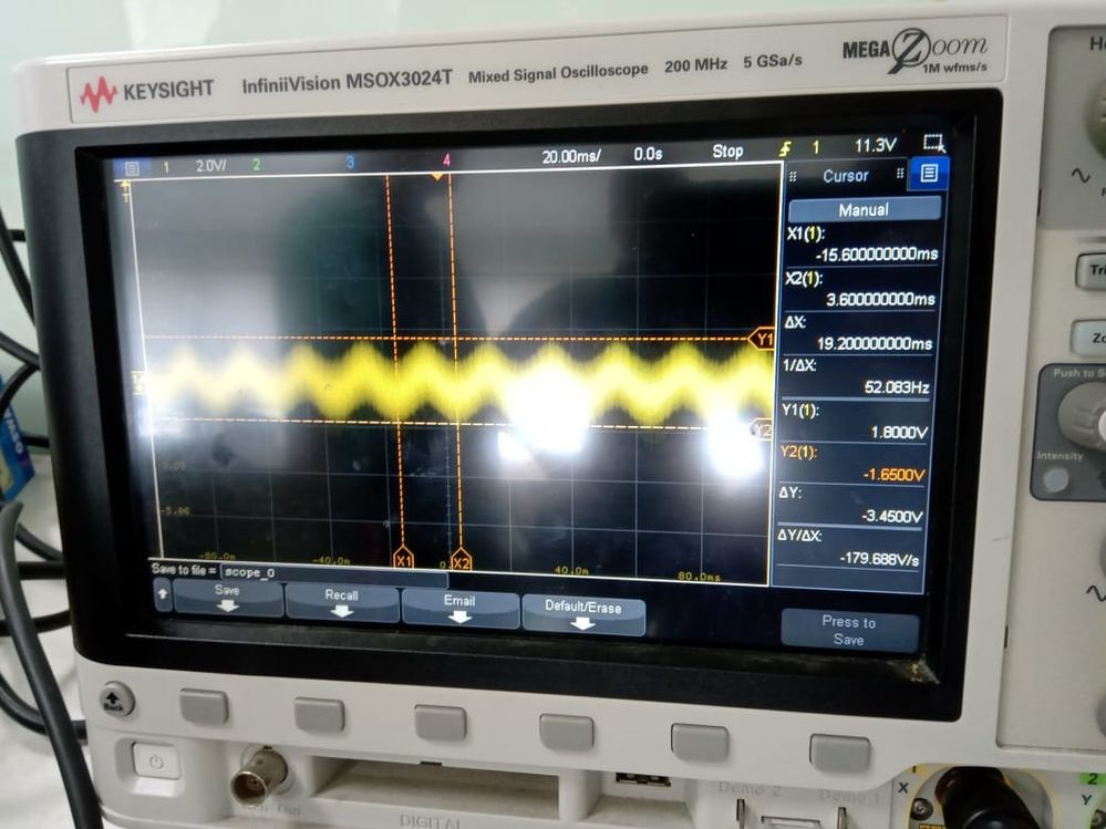

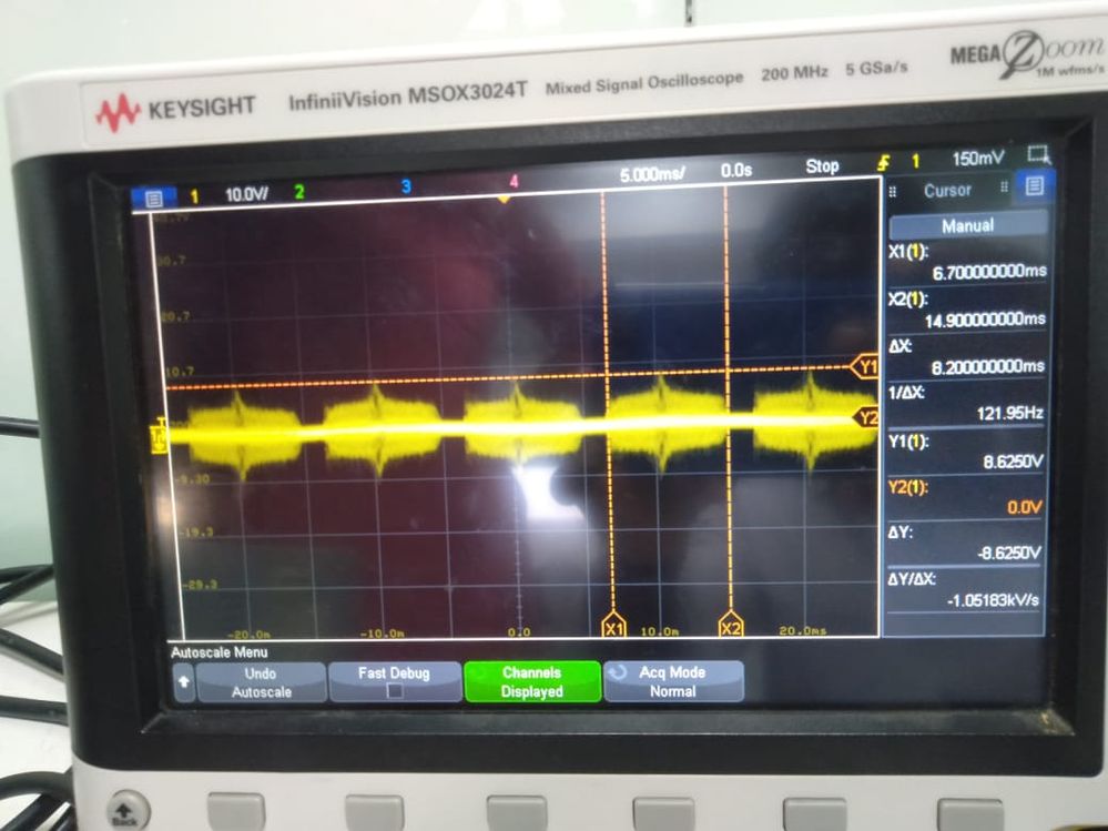

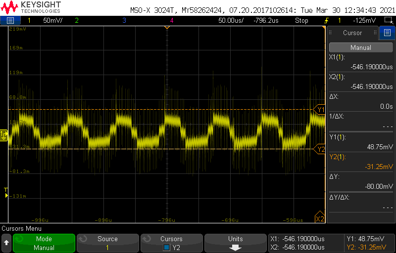

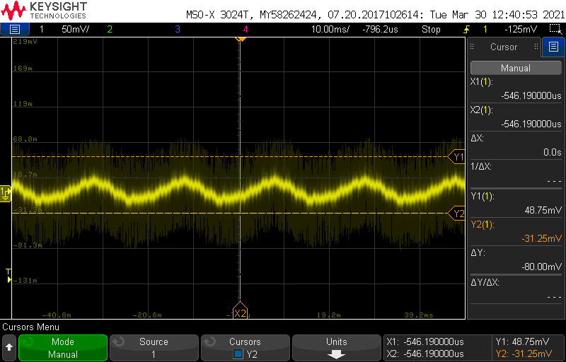

By using the above formula we calculated Voltage and Current. For Grid Voltage STPM34 is reading Correctly, we are facing the issue when reading inverter output AC voltage. I have attached waveforms across the VIP1 pin. I have changed the Capacitor across VIP1 pin 10nF to 100nF but also facing the issue same.

that looks like a very noisy signal.....
What about triggering the ADC reading only when the pwm event?
