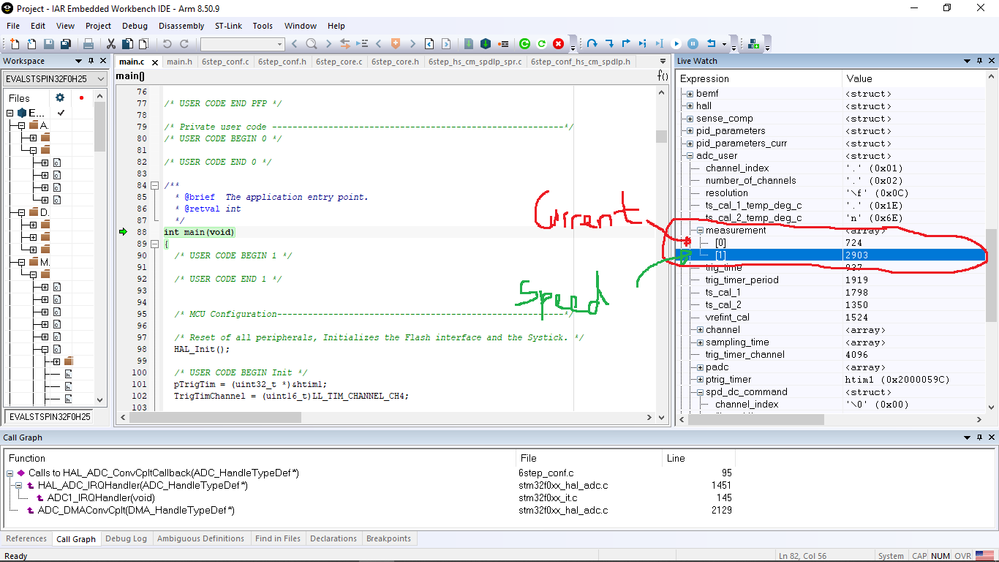

I dont think it does though because I get two seperate adc values, just that the first one seems to be incorrect as shown in this picture below
Will it still be possible to trigger the ADC to start converting by using a PWM signal from another timer if I use the DMA method? I am asking because my application requires me to sample the current value only in the middle of the gate PWM signal ON-time. And the DMA method seems to continously sample at all times?
