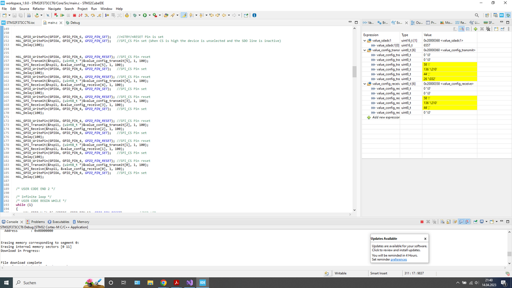

i try to programm an SPI communication protocol of an STM32F373CCT6. It should communicate to the powerSTEP01 in order to move a motor. The problem is that i dont get any answer of the powerSTEP01. Did i do anything wrong with my SPI communication setup?
I try to do so using the following conditions:
Thank you for your help in advance here is my SPI protocol code:

Hi Cristiana, thank you for your answer, SPI Mode 3 doesnt solve my problem but thank you for your help to understand that Figure 25. It is one more step in the right direction i guess^^I tried to set the configuration register of the powerSTEP01 and for this i am using the SetParam() command which(from my point of view, the datasheet is a little bit confusing) consists of the write part 000 and the Hexaddress 11010. These combined gives me an 8 bit command 0b00011010 == 0x1A. After this byte i send two more bytes to change the config register of the powerSTEP01.
After that i want to read the config register back and want to see if i changed something. I do this with GetParam() which is 0b00111010 == 0x3A and two more received bytes which should show the config register configuration in the two bytes over the yellow arrays.

I can only suggest to share with us the SPI signals behavior using a logic analyzer.
