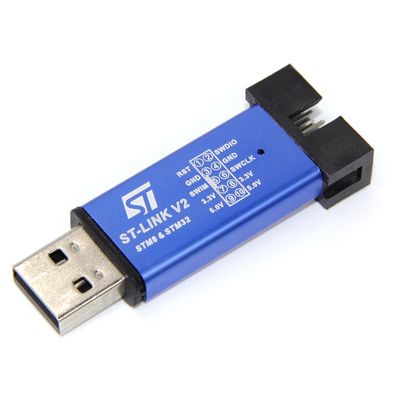

The blue tin can in your picture is an illegal clone of our ST-LINK/V2, which cannot be supported. Do yourself a favour and buy a genuine one from a reputable dealer, i.e. not on eBay or other platforms.
Regards
/Peter
2024-05-10 5:19 AM
before i shared only for the online reference image!! kindly ignore it.
