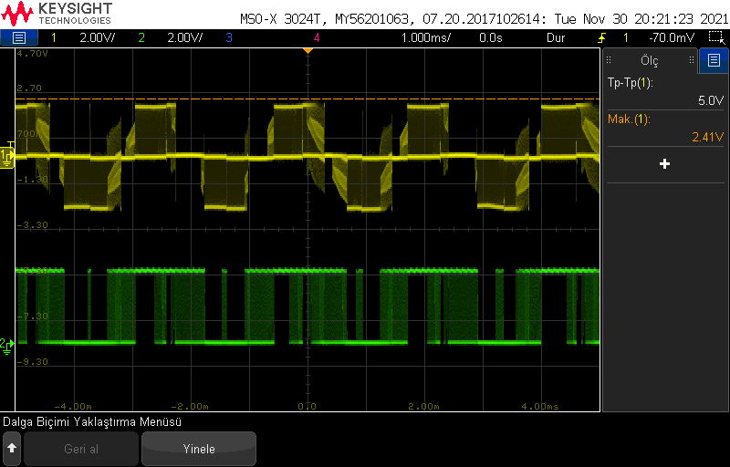

About the noise please provide a detailed description of what you mean. Some oscilloscope waveforms could be help (e.g. one motor phase and respective Op Amp signals).

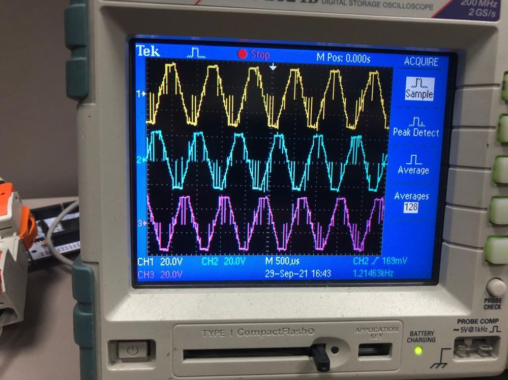

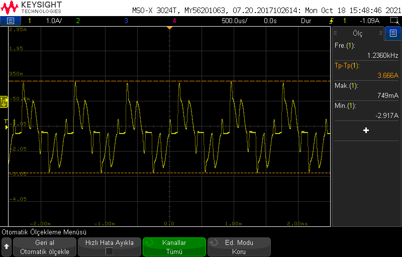

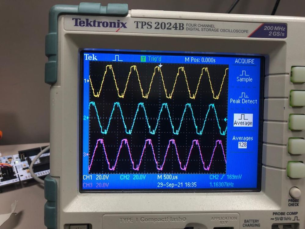

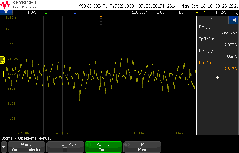

Based on our observations, supply voltage does not change. At the same environmental aspects, Air 40A ESC's noise is 86 dB and our ESC's noise is 92 dB. You can find motor phase and current signals files attached.

please provide the above requested waveforms: one motor phase and respective Op Amp signals in the same screenshoot.

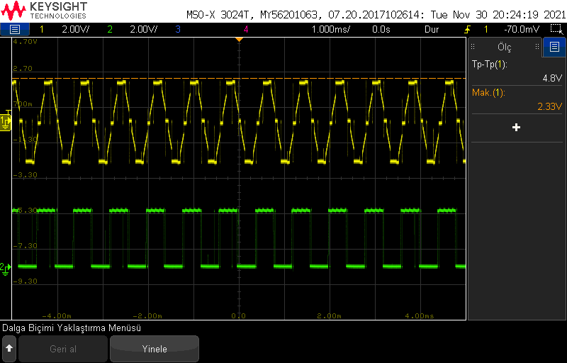

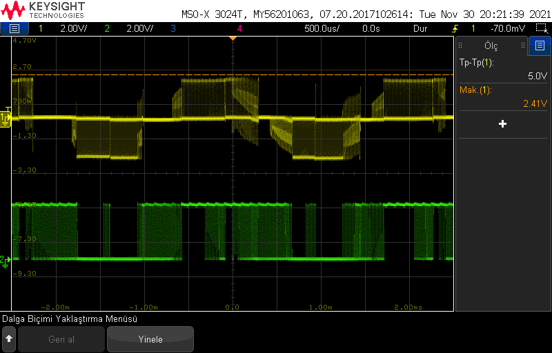

Hi Cristiana,
I noticed that I didn't add Opbemf1, Opbemf2, Opbemf3 and Opbemf4. You can find them below.
