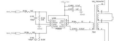

>I dont fully understand how PWMs from microcontroller can run this auxillary supply. Can microcontroller deliver this much high power?
No. The PM8834 is the driver, that drives the transformer; its clock/pwm is from cpu :
>the firmware available of this PFC as downloaded from ST website is not updated?
Possible - but it should work, as it is, because STM dont want to show a "demo board", that just blows up, if you test it - we can assume .
>But what surprises me is the heating of R154 even when auxillary supply is not connected to the gate drivers.
Right, this is no "nice feature". But as i showed more early, there are zeners, that (intentionally) burn some current, to keep voltage at desired level without using some active regulators. So there must be some resistor, to limit the input current to all this, R154. It will burn some power, but if everything ok, it should be in the limits, it can do long time. (So maybe heating up to 70° is no problem for a resistor. ) If it begins to burn, something is wrong...
