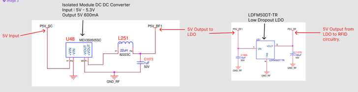

In my current design, I am using LDFM50DT-TR LDO for 5V output which acts as a source for RFID transceiver circuitry. LDFM50DT-TR is preceded by MEV3S0505SC (Digikey link) whose output goes to LDFM50DT-TR, please check the attached image for more of the circuit diagram.
I am planning to replace LDFM50DT-TR with another suitable LDO, please suggest a viable replacement for LDFM50DT-TR.

Well, an LDO is not necessarily a good choice for at least two reasons, firstly because the theoretical difference of 0V is a bit tight even for LDOs with an extremely small drop-out. SVR or PSRR of a normal LDO is rarely more than 30...40dB at the relatively high switching frequency of the preceding DCDC (here 60kHz), which does little to suppress interference. So if you want the LDO to filter the interference frequencies, you should choose an LDO with a corresponding PSSR at the switching frequency, or alternatively an LC-Pi filter.

1. the activity I am doing is of component obsolescence, hence the alternative components package in my scenario has to be TO-252-3, DPAK (2 Leads + Tab), SC-63 & from an online search I did, I did not find LDO with SVR or PSRR in 60kHz range.
2. Cannot add an LC-Pi filter, since I cannot modify the schematic & PCB Layout.

Incidentally, I had previously overlooked the LC filter 1µF+22µH in your screenshot, whose cut-off frequency of 33.9kHz is actually still too high. If the layout is fixed, you will hardly be able to replace L251 with one with 220µH or more, because the thicker wire results in a larger package of the inductor. But perhaps you can at least increase C1073 from 1µF to 10µF or more, as this offers better damping of the switching frequency of 60kHz (assuming a good layout).

Thank you for your valuable suggestion, of replacing the 1uF capacitor in the LC filter post-DC-DC converter, I will follow it through, and replace the 1uF with a 10uF capacitor which will shift the cut-off frequency to 10.73kHz which will be in the range of the PSSR bandwidth of all the TO-252-3 package LDOs, and update you with the measurement test results.

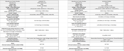

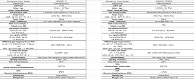

No worries, Peter, if possible can you suggest any suitable alternative from the ST power management portfolio?
do you think LP38691DTX-5.0_NOPB from TI or NCV5501DT50RKG from Onsemi will be a suitable alternative for LDFM50DT-TR? please refer to the comparison table i have made below, your insight will really help me.
Thank You,
Manan Mehta
2024-03-12 2:59 AM
I can suggest the L4931CDT50-TR as an alternative in your application, but I can't say anything about the other manufacturers.
