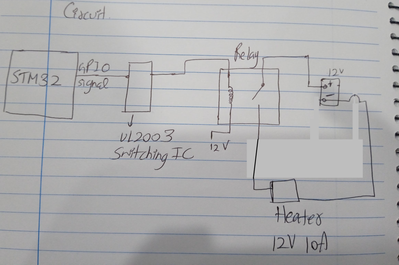

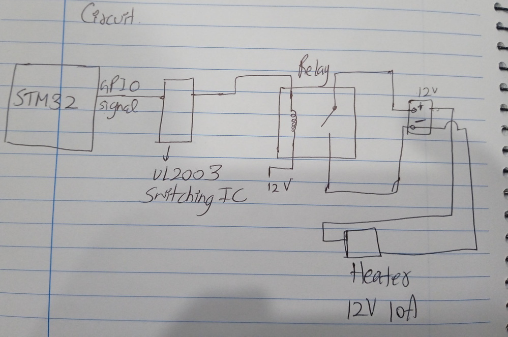

I am controlling Relay which controls heater using the switching IC here is my overall circuit.The coil voltage is 12V
Image rotated.
2024-12-13 12:09 AM - edited 2024-12-13 12:27 AM
You've marked @mƎALLEm's post as The Solution - so is the problem now resolved?
If yes, it would be helpful to describe what, exactly, was the problem, how you found it, and how you fixed it - for the benefit of future readers with similar problems who may find this.
If no, then we still need some more details:
Have you used an oscilloscope or logic analyser to see what's actually happening on the SPI wires between STM32 & MAX6675?
If you need to un-mark the solution, see:
PS:
As shown, your heater is permanently connected to your 12V supply, and your relay shorts-out that supply.
I presume you meant (something like) this:
yes?
