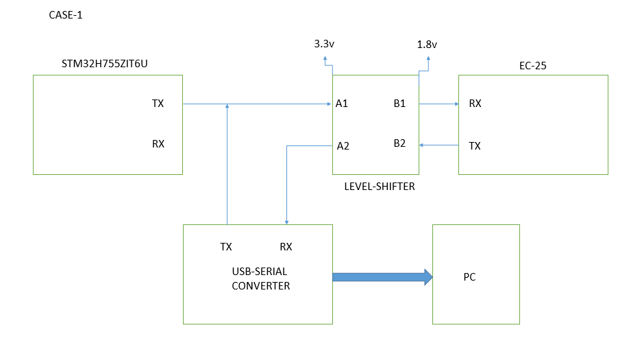

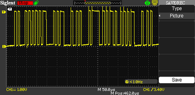

CASE 1:
Sending data from STM32 → EC-25, and the EC-25 responds. These signals are successfully captured using a USB-to-Serial converter.

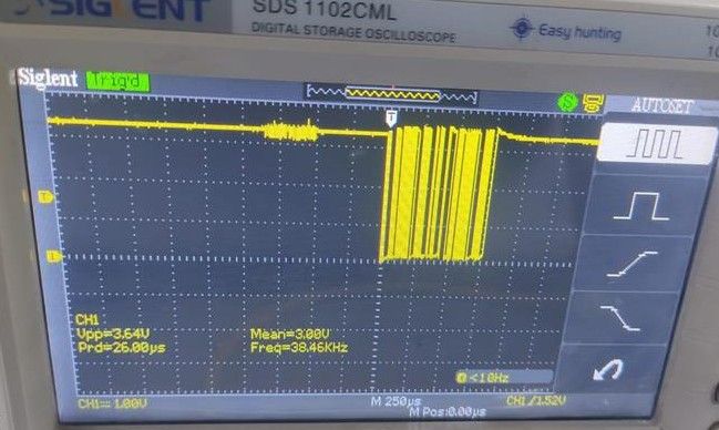

This is the signal captured from A2 where RX is connected to usb-serial converter.

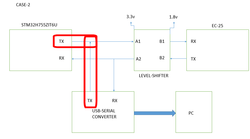

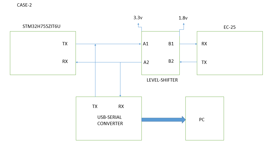

CASE 2:
When I connect the RX pin of the STM32 to the setup, even the USB-to-Serial converter stops working.
This is the signal captured from A2 where RX of STM and USB-Serial converter are connected.
2025-06-17 3:21 AM - edited 2025-06-17 3:28 AM
@pankajprasad100 wrote:CASE 2:
That's bound not to work!
You can't have two TX outputs shorted together like that - they will "fight" each other.

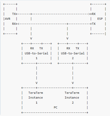

If you want to monitor both lines between the STM32 & EC25, you will need two USB-to-UART converters - as linked previously:
https://www.avrfreaks.net/s/topic/a5C3l000000UYWbEAO/t146507?comment=P-1422786

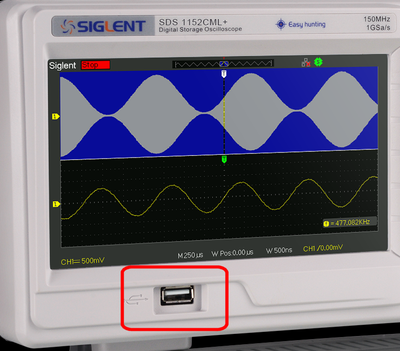

Your scope has a USB socket to capture screenshots:
This will give far clearer results that photos of the screen!

@Andrew Neil is correct in that you should not have both Tx pins connected. The Tx pins are push-pull outputs. The internal circuitry uses transistors to push high and pull low. So the STM32 is pushing high while you're trying to use the USB<>Serial adapter to push low during data transmission, which is a short circuit.

If the STM32 RX pin is not connected to A2, I can see the correct response (OK) from the module using a USB-to-Serial converter and viewing it in PuTTY. The signal on the scope also looks clean and properly framed.
However, as soon as I connect the STM32 RX pin to A2, the response disappears — some random data is in PuTTY, and the signal gets distorted.

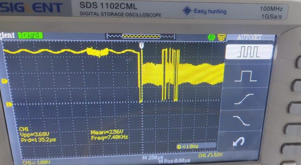

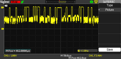

Attached is the oscilloscope trace showing the A2 signal when STM32 RX is disconnected.
Attached is the oscilloscope trace showing the A2 signal when STM32 RX is connected.

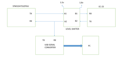

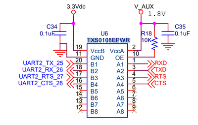

I’m using the TXS0108EPWR level shifter for voltage translation between the STM32 and the EC-25 LTE module.
Below is a snapshot of the schematic showing the connections.

From your scope plots, it looks like you have a ground problem.
Please show the full schematic, and some good, clear photos of your setup.
Your block diagram doesn't match your schematic excerpt:

Definitely looks like the A/B sense is wrong or there's a grounding issue between the 3.3V and 1.8V supplies.
The lasts scope trace looks like the ground's risen, or the 1.8V signal is modulated onto the 3.3V one.
