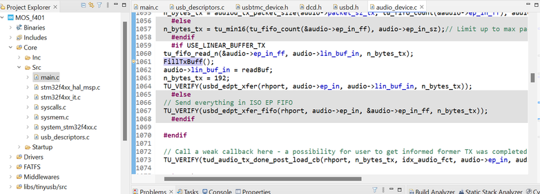

The following is the following callback audiod_tx_done_cb(), i am filling the USB linear buffer using global buffer readbuff as mention in the below image line number 1061 and 1062.
where, FillTxBuff is defined as follows;

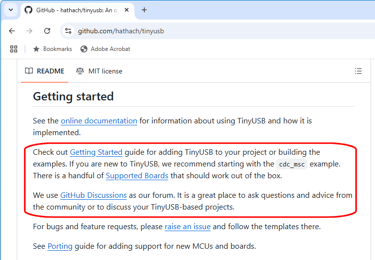

@sidharth_seela_at_amantya wrote:I have used tinyusb for USB support
You mean this: https://github.com/hathach/tinyusb ?
If so, that's not an ST project.
Have you followed their Getting Started advice:
Have you asked on their forum?
It says it's funded by Adafruit - so maybe also ask on the Adafruit forums?
