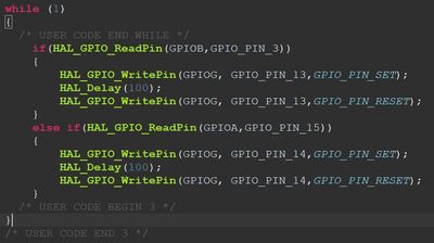

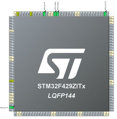

To verify whether the input signals are working correctly, I used the onboard GPIO LEDs to manually check the waveform behavior from each RS422-to-TTL output.
I've attached a video showing the test.
Based on the experiment, all signals behave as expected until I connect them to the TIM2 encoder input pin PA1. That’s when the abnormal behavior begins.
This suggests the issue may not be with the signal itself, but rather something related specifically to using PA1 as a TIM2 encoder input.
Let me know if you have any thoughts or further suggestions.
Thanks again!
