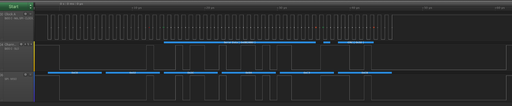

I found a good solution to read BiSS-C/BIS3 packets over a SPI bus. In my case I am reading 30 bits from a Zettlex Inductive Encoder into a Nucleo-G474RE STM32 development board. The Reference Manual (RM0440 Rev 7) has a subsection in section 39.5.9 called "Sequence Handling" that mentions how to get the clock to run as long as you need until you get any number of bits that you want:
"In receive-only modes, half-duplex (BIDIMODE=1, BIDIOE=0) or simplex (BIDIMODE=0, RXONLY=1) the master starts the sequence immediately when both SPI is enabled and receive-only mode is activated. The clock signal is provided by the master and it does not stop until either SPI or receive-only mode is disabled by the master. The master receives data frames continuously up to this moment."
I set my data size to 8 bits. I call HAL_SPI_Receive(&hspi, pdata, 6, 1000) to receive 48 bits (just needs to be more than 30 bits). Now can I parse through the returned pdata array and pull out the data bits, nE/nW bits, and CRC bits as I need them. See the included Logic Analyzer image to see how the data is the same no matter if it's analyzed as BiSS-C or SPI. Just needs to be a bit massaged (pun intended).
Good luck!
