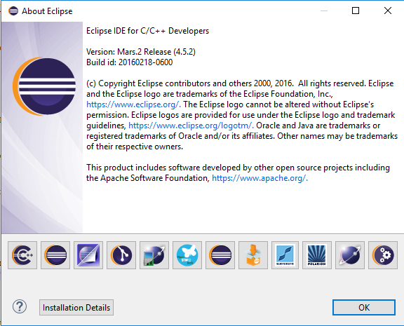

Eclipse version:
Posted on February 09, 2017 at 17:22
The version which is required here is the one for STM32 plugin ( blue butterfly )
This specific help have come along 1.12.1 version.
If you upgrade on latest 1.13.1 for sure you will get it
Olivier
