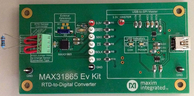

2025-07-23 2:05 AM - edited 2025-07-23 9:42 AM
@Andrew Neil wrote:I would suggest that you start with the driver code provided by the manufacturer.
They also have an evaluation kit:
That would allow you to see exactly what the SPI interactions should look like.
Then you can replicate that in your STM32 code...
