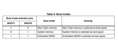

Im having a devention dev10 fpv controller, it is detecting by windows but not recognizing via Dfuse tools to flash its firmware to "Deviation". So I decided to flash bootloader via ST link V2 tool. Anyone please help me to get the STM32F103xC pin out config to connect to ST link V2 adaptor and its boot0 setting too.

DfuSe is marked as NRND on its home page. For that please use STM32CubeProgrammer instead.
To configure boot pin I recommend you to refer to RM0008 section 3.4 boot configuration.
Also I advise you to take a look to MOOC - STM32 boot and startup tips - YouTube may help you.
