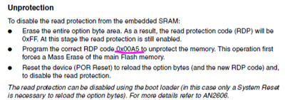

Did you also try writing 0xA5 with cli ?
(No guarantee -- what will happen.)
2024-03-15 10:02 AM
I never tried it, but I don’t think it is possible to write OPTKEY1 and OPTKEY2 if protection level 2 is set (OPTLOCK will be cleared afterwards!).
I will try 0xA5 on Monday (home office today) – but I think this value is valid for other chip series only.
