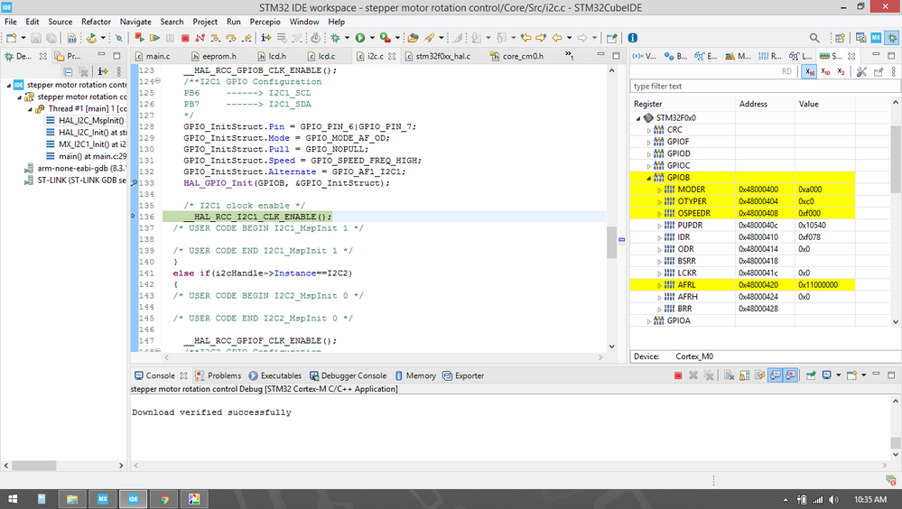

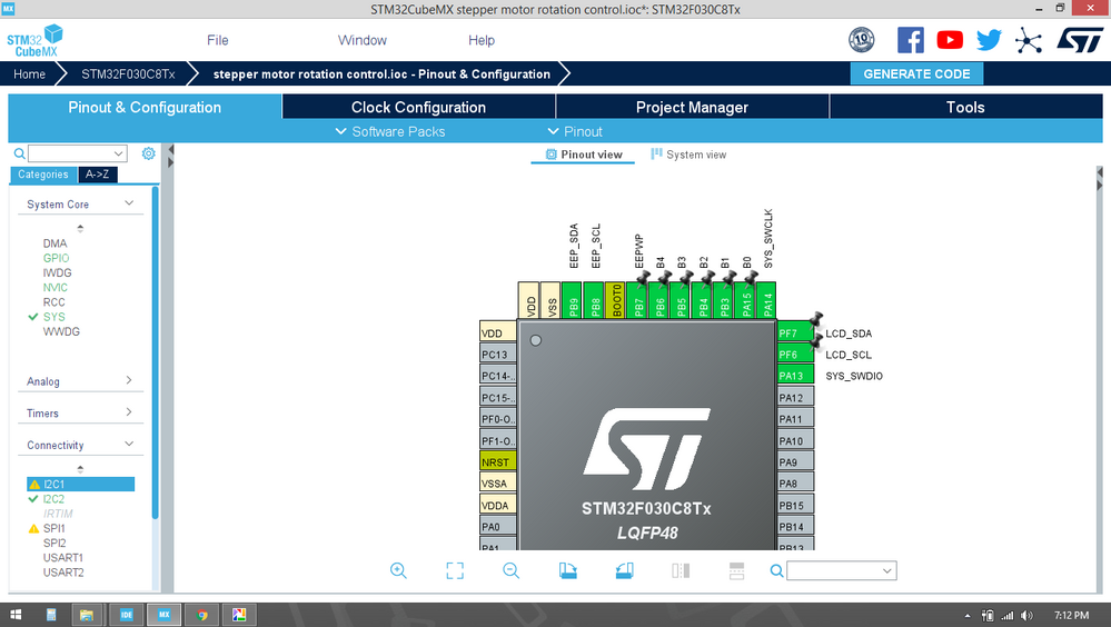

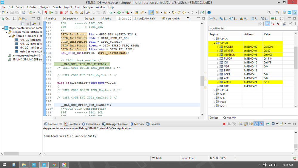

My problem with I2C1 EEPROM not working in I2C1 I'm using alternate pins and in cods line number 132 alternate function it's configured.
2021-12-29 7:51 PM
1) PB8 PB9 configure as I2C1 then I get EEPROM CONNECTED
as you said i tried I2C1 HAL_I2C_IsDeviceReady is returns HAL_ERROR is there hardware EEPROM problem or any other issue?
2) PB6 PB7 configured as I2C1 then its work fine i get clock in oscilloscope FOR TRIAL
so what is the problem in gpio init code how to solve it?
both cases 1&2 GPIOB RESISTOR VALUE image is given.
