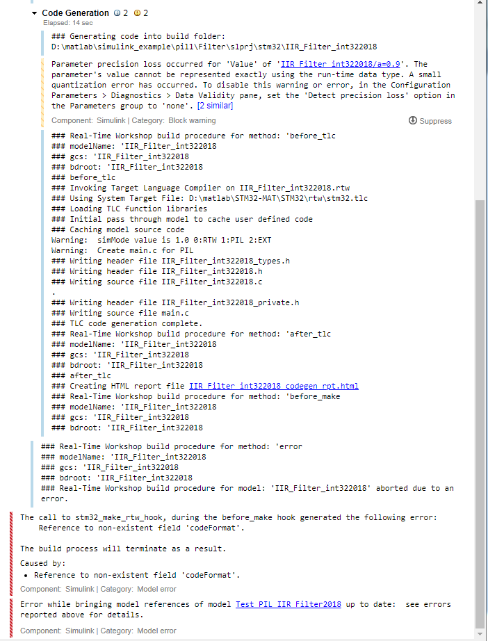

I use the STM32demo /PIL/"Filter" with the matlab 2019a, Then , I get the next information
And when I used the matlab 2018b, there are some others errors"invalid index"", if the STM32-MAT target is older ? so which matlab version is best matching?

This problem is solved with the version 5.1.0 of STM32-MAT/TARGET, published end of July 2019.
Regards.
Cyril
