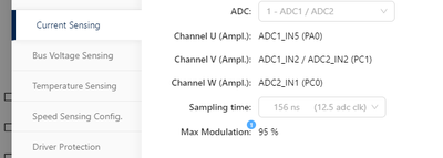

Max Modulation Index could also limit the current. Check MMI value:
If it is low, decrease the PWM frequency.
2025-07-08 10:11 AM
Thanks! That fixed my problem. How do you chose an optimal PWM frequency? I was at 16kHz, and went down to 12kHz and that fixed my issue. The SDK shows 100% modulation at 16kHz and it does not seem to update that percent when changing PWM frequency.
