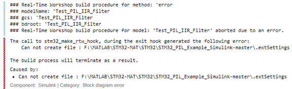

In my next try to run the "Test_PIL_IIR_Filter" example, I'm faced with an other error.
Does someone can help me on undersdanding and fixing this error?

Does the directory exist? Can you create such a file in the directory?
AV or other software preventing that from occurring?

2019-06-17 10:24 AM
Yes, the directory exist.
The file ".extSettings" is generate during the build of the Simulink model.
For the last question, I don't know.

Hi @BTrem ,
This problem is not reproduced with the version 5.1.0 of STM32-MAT/TARGET, published end of July 2019.
While working on this version the followings tests were successful for PIL:
- F429ZITx @ 180 Mhz, USART1: OK
- L476RG @ 80 Mhz, USART2: OK
Regards.
