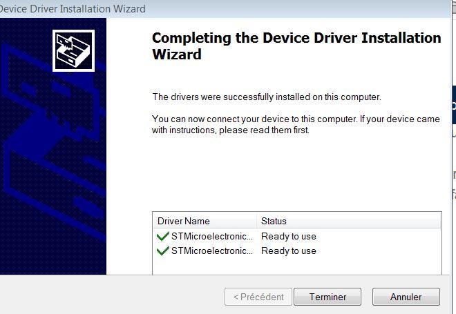

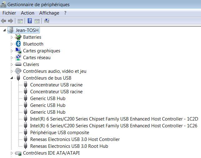

my PC can't communicate with the stm32F7508-dk board. I installed st-link USB driver successfully (see image) but it doesn't appear in the windows device manager (se image) and it doesn't run. In the ST-Link utility program I have 'no ST-LINK detected.
Why ?

perhaps I am wrong but before connecting a high quality cable I would like that the ST-Link USB driver to appear in the 'USB bus Controller' (in french it is controleur de bus USB) !
I uninstalled the Renesas USB driver et reinstall the St Link Usb Driver with C:\utilitaires\stm32\stlink_utility\ST-LINK_USB_V2_1_Driver\dpinst_amd64.exe
It says ok but nothing appears. Am i doing it wright ?
Maybe the ST-Link is "Pereferique USB composite". Often it is a composite device with two or more functions.
