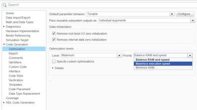

Hi Ch,
I had a similar issue using ADC sampling Triggered by HRTIM. It was stuck at 50kHz using HAL (even without Embedded Coder).
I do also work with Embedded Coder Support Package for STM32 (this is based on LL library instead of HAL, so It is supposed to be faster).
If you can not choose the code generation library (not sure if it is allowed in Nucleo Boards Support Package), I would try to set Optimization level with Priority to Maximize Execution Speed:
Hardware Settings >> Code Generation >> Optimization >> Level: Maximum >> Priority: Maximize execution speed
