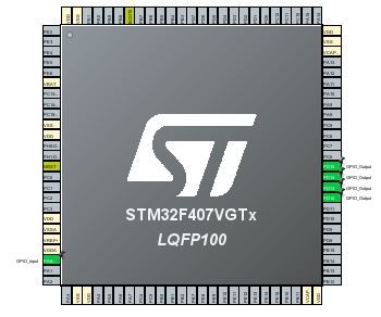

I'm trying to get started using STM32-MAT-TARGET, and I've tried a very simple project but it does not work. First I started the project from STM32CubeMX V 6.0.1. I selected the MCU, not the board (to keep it simple).
The push but (PA0) was set as input and the LEDS (PD12 to PD15) as output

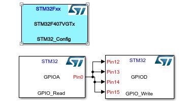

Then I made a very simple model in MATLAB Simulink (2020a) with the
following Model Settings for STM32-MAT-TARGET.
The simulink model is very simple. If the push button is pressed, the LEDs will be on and if the push button is released, the LEDs will be off.

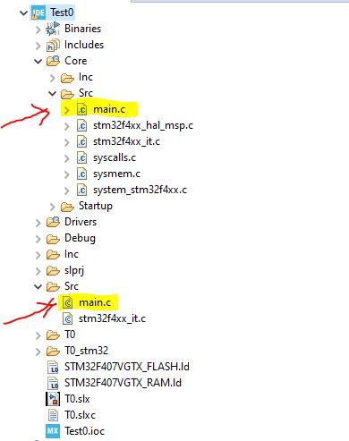

My problem is that it does not run in the board. I tried to debug it by software and noticed that the project has two main functions and two "main.c" files:
I guess the first one is generated by STM32CubeMX and the second one by simulink. The first one has an empty infinite loop. The second main function (in the second "main.c" file), has a program that does what the simulink model says. If I debug the program executes the first main function and does nothing (empty infinite loop).

Hello, generally the Matlab working directory shall be the MAT-TARGET directory before project generation. The two main()-containing functions is a failure of the generator, possibly because CubeMx can't find the Simulink-generated main.
You can try cd'ing to the MAT-TARGET directory, or manually combine the two main.c files.
