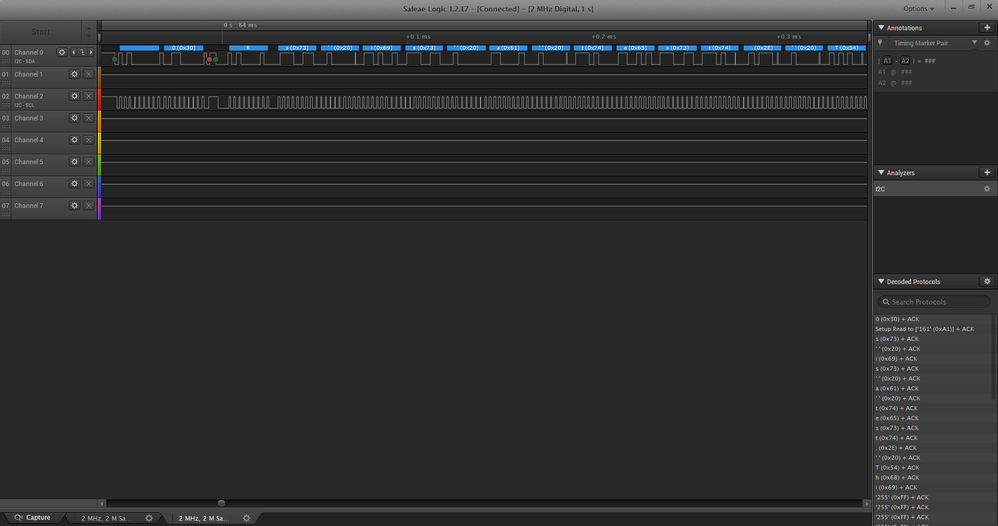

I also check this with logic analyses. It's same:
And I check SCL, SDA and power 3.3 Vpp ripple. Its all in good. I also try with 100kHz speed. Same result.
