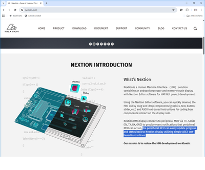

The Nextion site says, "the peripheral MCU can easily update progress, and status back to Nextion display utilizing simple ASCII text-based instructions" (my emphasis)
"ASCII text-based" would usually mean that you don't have hex values like \xFF in them - so are you sure that's correct?
