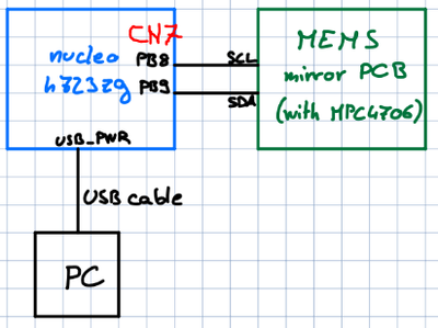

I've this circuit connected to the microcontroller:
Using an oscilloscope and a multimeter I'm always measuring 0V and I can't see the SCL and SDA signals.

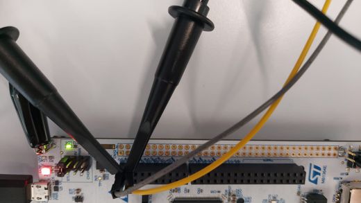

2026-01-02 2:33 AM - last edited on 2026-01-02 4:39 AM by Andrew Neil
I'm measuring on the PB8 and PB9 pins as shown below:

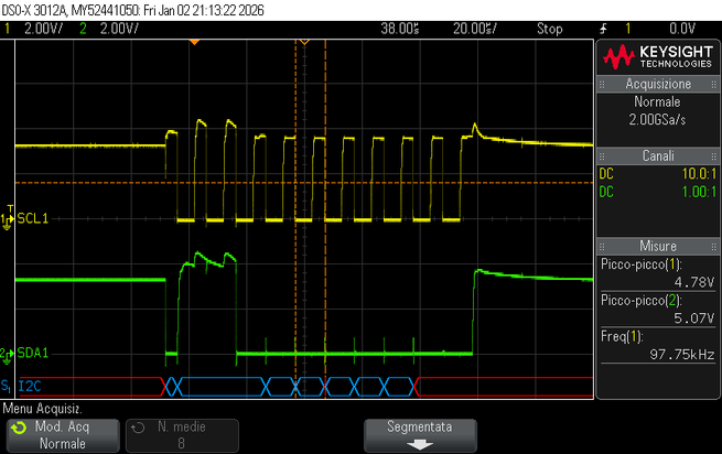

Now I can see the SCL signal but on the SDA signal I see only the slave address, the data is always 0.

2026-01-02 4:49 AM - edited 2026-01-02 4:56 AM
@DannyB wrote:Now I can see the SCL signal
Previously you said you were seeing nothing - So what changed?
Please show a trace of what you see - using your scope's screen capture facility rather than a photo.
Please see How to insert source code - not as screenshots.

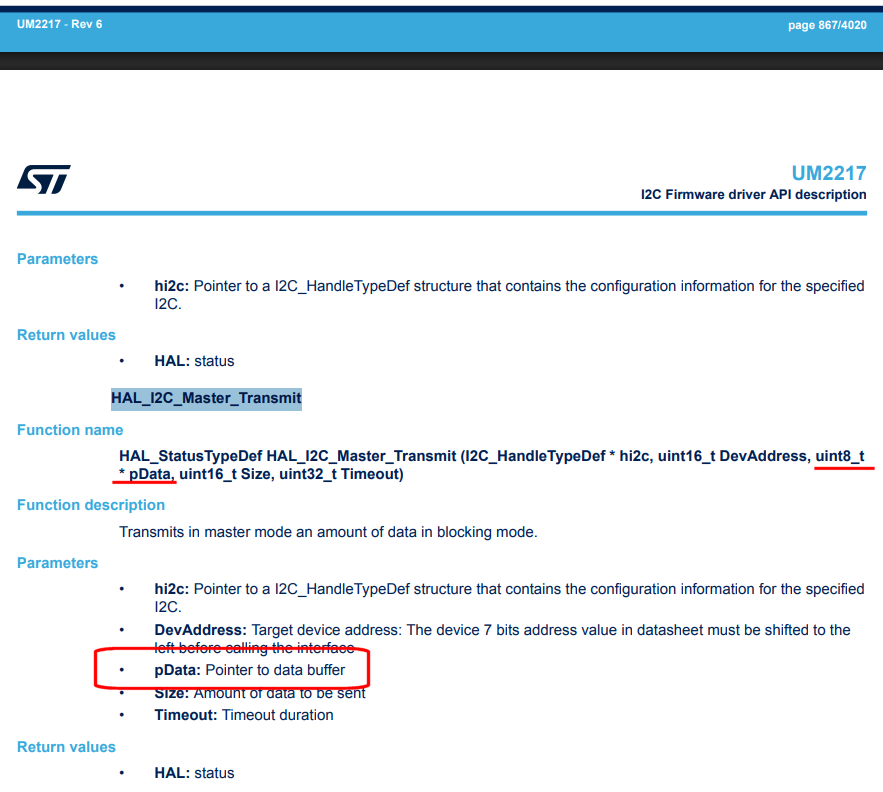

@DannyB wrote:When I send the function
HAL_I2C_Master_Transmit( &hi2c1, DAC_Address, MEMS_Digital_Input2, 1, HAL_MAX_DELAY );I've a warning telling this:
See the documentation of the HAL_I2C_Master_Transmit function:
There you can see that argument 3 is pData - which is a pointer to a uint8_t.
But your code supplies MEMS_Digital_Input - which is an actual uint8_t:
You need to pass a pointer to that variable.
PS:
Note that the documentation of the HAL functions is provided in the source:
* @brief Transmits in master mode an amount of data in blocking mode.
* @PAram hi2c Pointer to a I2C_HandleTypeDef structure that contains
* the configuration information for the specified I2C.
* @PAram DevAddress Target device address: The device 7 bits address value
* in datasheet must be shifted to the left before calling the interface
* @PAram pData Pointer to data buffer
* @PAram Size Amount of data to be sent
* @PAram Timeout Timeout duration
* @retval HAL status
HAL_StatusTypeDef HAL_I2C_Master_Transmit( I2C_HandleTypeDef *hi2c, uint16_t DevAddress, uint8_t *pData, uint16_t Size, uint32_t Timeout )
2026-01-02 6:01 AM
@Andrew Neil as you said I added a GND connection between the Nucleo and the mirror PCB usign the GND of one of the probes.
This is what I see:
