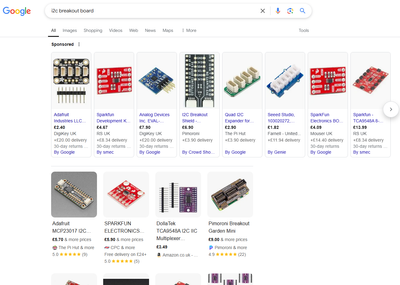

2025-01-30 6:49 AM
There are loads of low-cost "breakout" boards for common I2C devices...
