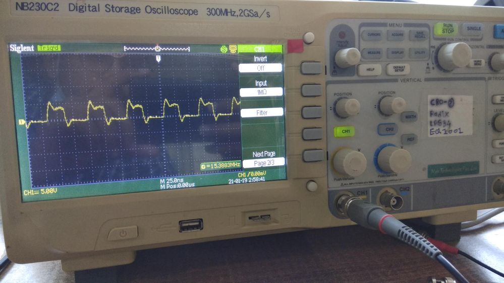

}This is my simple code to generate PWM in MHZ using FastPWM. When i check on CRO its showing frequency about 16 to 19 MHZ but not abel to see square waves. what am i missing here? Can someone please help?

PA8 is also MCO1. Check if you can use that way. Check also, that alternat functions are set the right way.

Just for Information. I am able to get proper 16 MHZ output on PWM pins like D6,D9,D10,PA8 etc... with the same code posted in question. It was probe issue and input impedance issue. I have set input impedance to 1 Mega-ohm. Thank you.
