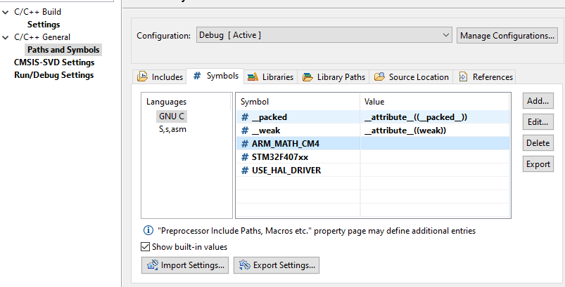

I tried to use DSP CMSIS Library, I included the libraries and adjusted the Paths and Symbols but when I tried to build the program I get this notification.
Cannot run program "arm-atollic-eabi-gcc": Command line too long
How I fix this problem ?
