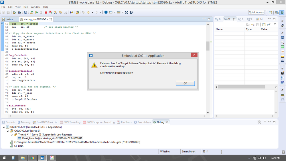

when i press debug button Target Software Startup Script Error comes.
there is no change in startup script file it is by default.
so what is the problem and how to solve it?

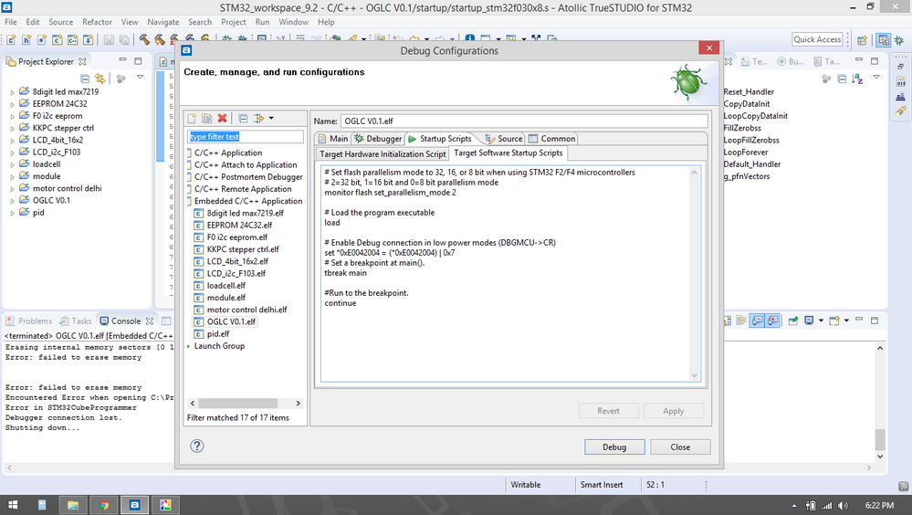

Line 6 is the "load" command.
2021-04-02 8:50 PM
problem solved by comment it out
# load
