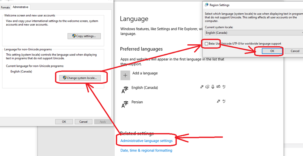

2021-08-12 7:20 AM
I had the same problem, the problem is not related to Atollic itself, we need to diable utf8 for worlwide language in Windows
2024-01-29 6:30 AM
You are a genius. Thanks.
