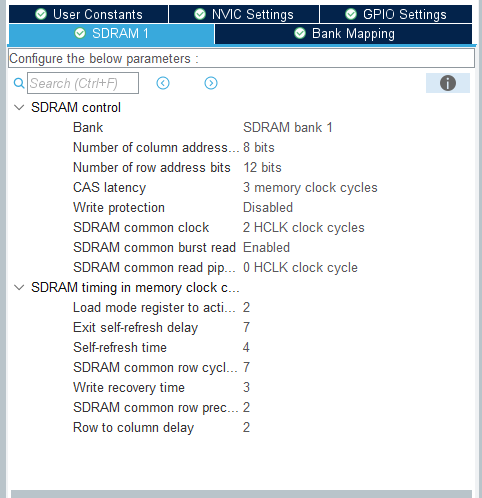

SDRAM:

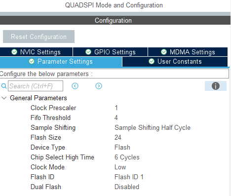

QSPI FLASH:

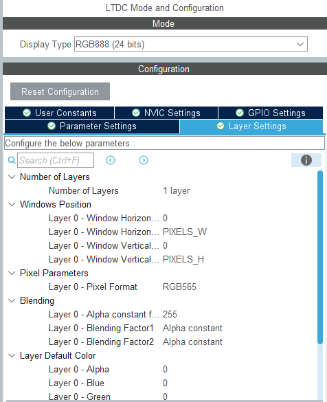

LTDC:

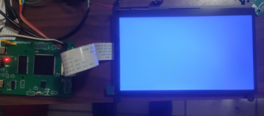

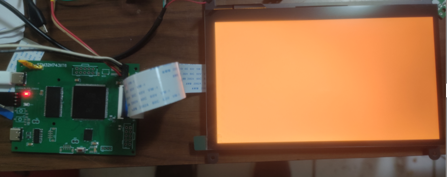

I have follow this post cube ide project https://github.com/JIU10/stm32h7_ltdc_dma2d/tree/master and it's work.

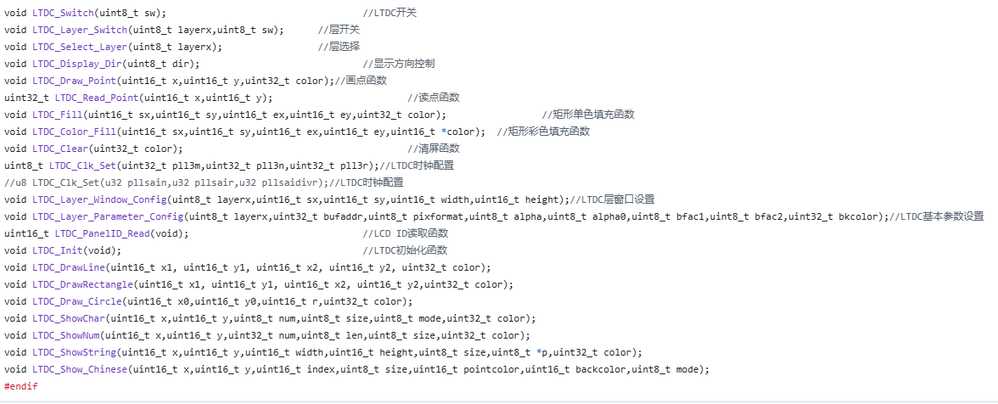

1 With the ltdc driver function below can i implement lvgl if yes how can i do if they are some link ?

The lcd is working with ltdc driver function above now i am asking how to implement lvgl
