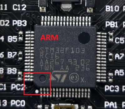

MCU: STM32F103RCT6
Toolchain: Keil MDK v5.31 + DAPLink debugger
Behavior:
Program flashes successfully via DAPLink.
Debug session starts but never enters main() – halts at address 0x200001E0 (check Disassembly/Register window).
All debug buttons (Step, Run) are grayed out except Reset/Stop.
Key Observations:
Same code runs correctly on another STM32F103 board.
Rebuild/Clean did not resolve the issue.
The "Option for target" as below.
2025-04-02 5:54 AM - edited 2025-04-02 6:41 AM
From the image you shared I bet this is not a genuine STM32.
- No "ARM " marking
- There is a notch and a hole-like on one of the corners.
- QR code for newer package versions?

If the MCU itself is indeed a "fake", you don't know whats in it. And thus you can't predict it's behavior.
I don't know where these fake MCUs come from and how they they created. But obviously they work partially.
My suspicion is these chips are rejects from original ST production, bough up for next to nothing and housed professionally by some shady elements. Cloning an IC via reverse engineering is expensive and time consuming, and clones thus cannot undercut the original - if they share a market.
I would cut the losses, stop wasting time, and get proper MCUs.
If you have the equipment, you can unsolder the fakes from the boards and replace them with proper one's.

@Ozone wrote:If the MCU itself is indeed a "fake", you don't know whats in it. And thus you can't predict it's behavior..
@merose You might be able determine something using the this previously-mentioned utility:
https://mecrisp-stellaris-folkdoc.sourceforge.io/bluepill-diags-v1.640.html
@Ozone wrote:I don't know where these fake MCUs come from and how they they created.
Some of them are bona-fide 3rd-party "compatible" chips - much like a huge number of manufacturers had (some still have) "8051-compatible" products.
Some of them might even be "enhanced" versions (again, like 8051/2).
Others may be just plain duds
See: https://mecrisp-stellaris-folkdoc.sourceforge.io/bluepill-diags-v1.640.html#clones
and: https://mecrisp-stellaris-folkdoc.sourceforge.io/bluepill-diags-v1.640.html#bluepill-mcu-candidates
Also: STM32 - Originals, Clones and Counterfeits
Another problem with buying from places like ali express, amazon, ebay is that you have no guarantee that any two boards will actually use the same chip.
That's one reason why they are cheap. You gets what you pays for!
@Ozone wrote:I would cut the losses, stop wasting time, and get proper MCUs.
Absolutely!
@merose Get a genuine Nucleo board - which comes complete with a genuine ST-Link; eg,
https://www.st.com/en/evaluation-tools/nucleo-f103rb.html
At least, use that to get familiar with the part and the tools - then, maybe, you will be equipped to dig into what's going on with these fake/clone chips
