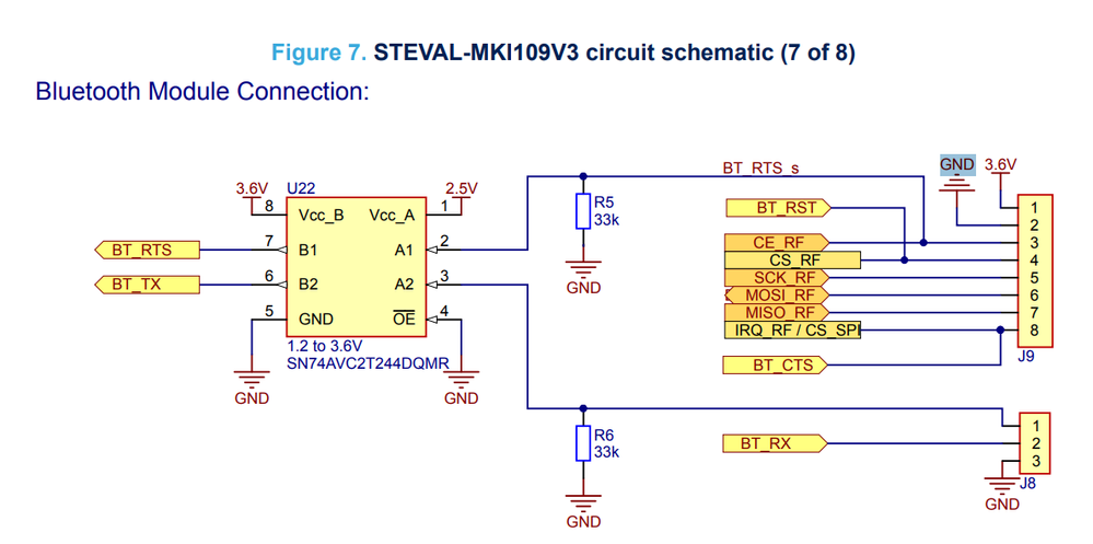

Objective:
We would like to print the data serially using the same commands, but over Bluetooth, not USB.
The accessory board STEVAL-MKI115V1 is no longer available in the market.
We tried using an HC-05 Bluetooth UART module, connecting it to BT_TX and BT_RX (J9 connector), but it did not work, so the default MKI109V3 firmware support UART input/output on the BT_TX / BT_RX pins ?
Any guidance or documentation regarding UART usage or supported alternative Bluetooth modules would be greatly appreciated.
Thank you.

Not only was the STEVAL-MKI115V1 discontinued a long time ago, but also the STEVAL-MKI109V3, but for the latter there is a replacement, the STEVAL-MKI109D, on whose DIL24 socket the same sensors can be plugged in.
It should be noted that the BT module SPBT2532C2.AT was used on the STEVAL-MKI115V1, which was also discontinued many years ago. However, it was not controlled via RX and TX (software handshake), but via CTS/RTS (hardware handshake). Therefore you would have to simulate the hardware handshake using the CTS/RTS lines.

Hi Peter,
Thank you for the explanation. I tried to work based on the solution you described, but unfortunately it is not working for me. I would like to better understand how the RTS/CTS hardware handshaking works in this case.
Here is what I have done so far:
I am using a USB to UART TTL converter (FT232RL, 5V / 3.3V)
I connected it to STEVAL-MKI109V3 using the following signals:
TX
RX
RTS
CTS
GND
On the PC side, I am using a serial terminal (for example Docklight) and I enabled the RTS/CTS hardware handshaking option.
However, I do not see any data communication at all.
I also tried providing an external 5V power supply on the J4 connector, and then repeated the same procedure, but the result is the same — still no communication.
Could you please explain how RTS/CTS handshaking is supposed to work on this board?
Any guidance, signal description, or timing requirements would be very helpful.
