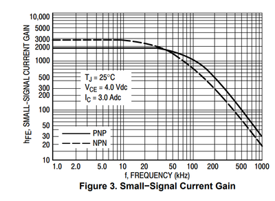

These (old) darlingtons are more for small audio amps, see :
From ds i would recommend to use it at max. 30kHz (sine) , over 30kHz gain falling.
