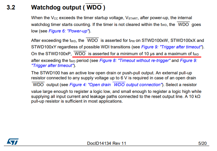

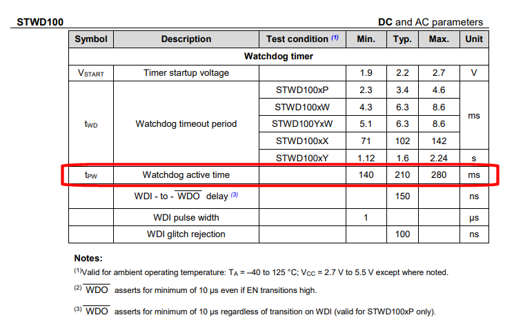

@tensaisakuragi06 wrote:The remaining problem is this: when i adjust my timer to 2 sec, every transition, WDO toggles. I dont want the toggling process
That seems consistent with what the datasheet says:
So the WDO gives a pulse output with a width between 10us and 280ms.
Are you wanting it to stay asserted permanently once the watchdog has "fired" ?
