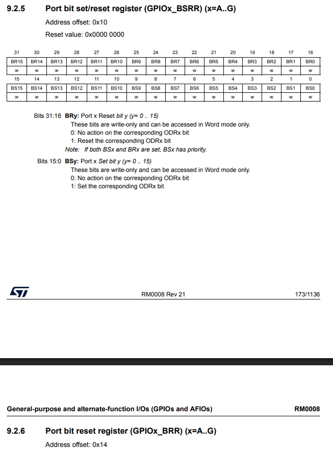

2025-09-01 1:41 AM - edited 2025-09-01 1:41 AM
Also, rather than a read-modify-write (RMW) on ODR, look at BSRR and BRR:
via: https://www.st.com/en/microcontrollers-microprocessors/stm32f103c8.html#documentation
