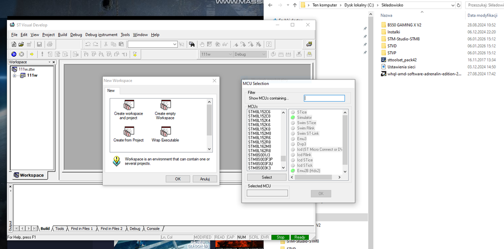

I'm using STVD version 4.3.12, no matter create an empty project or open the existing project.
The MCU selection in Project Setting always empty. But the same STVD installation package works in some other computers.
My computer is 64-bit x64-based processor, running Windows 11 Enterprise Version 24H2.

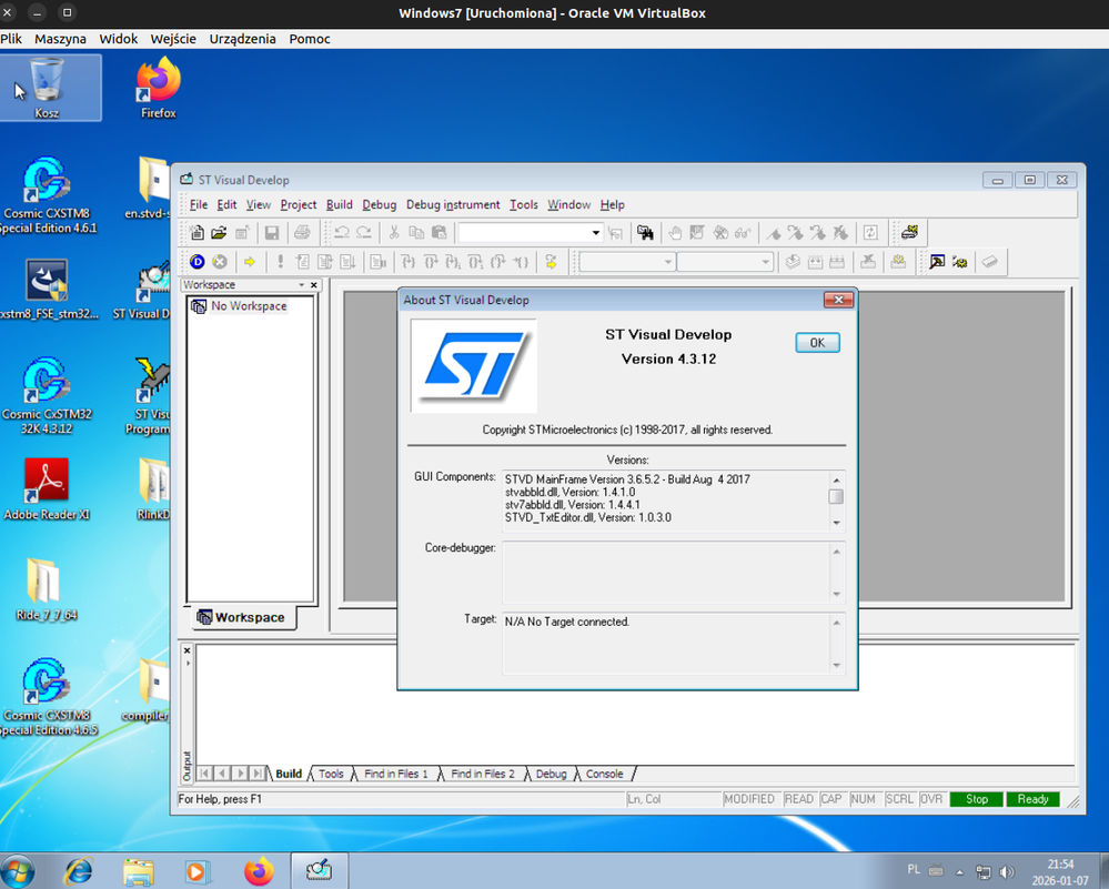

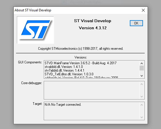

2026-01-07 1:21 PM
2026-01-07 1:24 PM

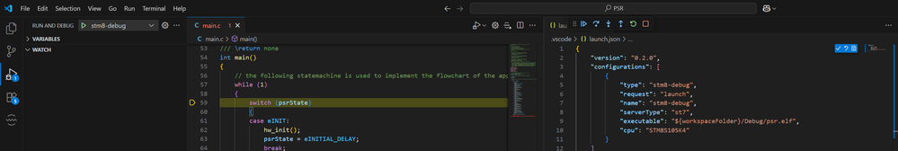

2026-01-08 12:12 AM - last edited on 2026-01-08 3:18 AM by Andrew Neil
It's weird, sometimes even doing nothing my Win11 64-bit system can select MCU normally, but after restart computer back to empty issue. Since VirtualBox come with a cost, I'll skip that. I'm dropping STVD and moving to VS Code with the STM8 Debugger extension for debugging. Even it's not stable but at least a workaround way.
