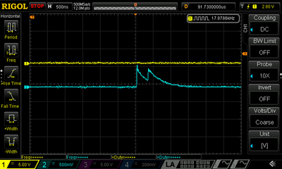

When I enable the ADC1 Scan Mode and DataBuffer with ADC_Channel >= ADC1_CHANNEL_2 TIM1_CH2N waveform distorted.
Oscilloscope CH1(Yellow) -> TIM1_CH1N
Oscilloscope CH1(Light Blue) -> TIM1_CH2N
For example when ADC_Init() with ADC1_CHANNEL_2
when ADC_Init() with ADC1_CHANNEL_1
ADC1_CHANNEL_2 is the AIN2 but Before the operation, i program the option bytes for enable the complementary channels.
What causes the distortion?

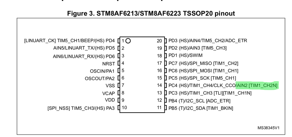

Edit: I put the wrong MCU picture. Take care this.

so you switching on same pin between two functions : adc in vs pwm out .
You , by using one pin on two functions and switching between them.
So decide to use the pin for one of the possible functions and you get this function without "distortion".
ADC sampling on a (open) pin has to give some "effect" , as the adc input (sampling cap ) is switched to the pin , to be charged here; thats why any pin to be read needs some capacity to GND or low driving impedance (from opamp or esle..).
2026-01-05 3:16 AM
Hi, i think you misinterpret,
I configure PC4 as a CH1_CH2N.(Its alternating property is AIN2 but i didn't configure it to ADC)(before, i program option bytes to enable complementary channel)
GPIO_Init(GPIOC, GPIO_PIN_4, GPIO_MODE_OUT_PP_LOW_FAST); // CH2NI want to use PD3 pin as a analog configruation -> AIN4
I can able to read PD2 (AIN3) but when i need to get AIN4 and AIN3 same time i enable ADC scan mode
But when i calling this for this purpose
ADC1_Init(ADC1_CONVERSIONMODE_SINGLE, ADC1_CHANNEL_4, ADC1_PRESSEL_FCPU_D2,
ADC1_EXTTRIG_TIM, ENABLE, ADC1_ALIGN_RIGHT, ADC1_SCHMITTTRIG_ALL,
DISABLE);It create a problem PC4 that prevously defined as a Timer channel.
I didn't define it as a ADC previously
2026-01-05 3:43 AM - edited 2026-01-05 3:49 AM
...maybe - or you haven't described the problem correctly. :)
Because in first post you wrote: > When I enable the ADC1 Scan Mode and DataBuffer with ADC_Channel >= ADC1_CHANNEL_2 TIM1_CH2N waveform distorted.
So you used same pin for adc and pwm - this cannot work. Bad setting.
NOW you > want to use PD3 pin as a analog configruation -> AIN4
- that should work, AIN4 is not on PC4 , so pwm here should work.
-> If using pwm on PC4+7 and adc on PD2+3 , still gives a problem on PC4 ?
