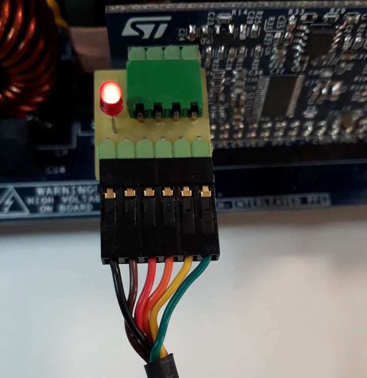

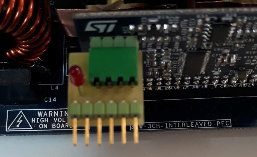

The programming procedure described below must be performed only when the interleaved PFC is NOT CONNECTED TO THE MAINS.Programming procedure detailsProgramming procedure detailsAs soon as the adapter will be connected with the cable FTDI, the LED on the top will be lit.

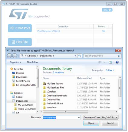

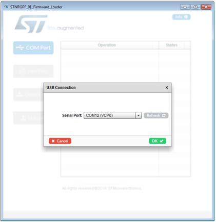

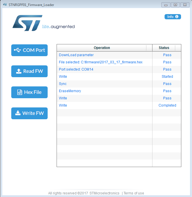

and follow the below listed steps:*.hex file selection
firmware download
