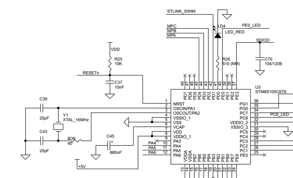

I am using below circuit with my STM8S105C6 device. VCAP 680nF (recommended 480nF to 3300nF) and I am able to program it a couple to times.
Currently I am also facing same issue. Once it gets programmed, I can reprogram it multiple times but as I remove and reconnect the ST-Link, it is throwing same error.
Still trying to figure out what's wrong here. :\ :(
