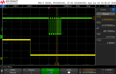

I’ve followed the entry sequence described in UM0470, and I believe the waveforms match what's expected. Attached below is a screenshot from the oscilloscope:
Yellow trace = RESET pin
Green trace = SWIM pin
As you can see:
A long low pulse initiates the SWIM entry sequence.
Followed by 4 x 1kHz pulses and 4 x 2kHz pulses.
Then I set the SWIM line high and switch it to input mode to await the slave response (Step 4 per UM0470).
However, no response is received from the target. The line stays high and never toggles.

2025-06-04 11:10 AM
If the target has an enabled watchdog timer and no main firmware, it could be resetting before responding. Either disable the watchdog or flash a basic dummy firmware to keep it alive.
