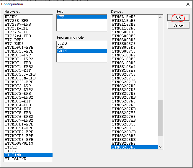

2022-09-06 12:45 PM
Hi Tesla, thanks for your quick response.
Connections:
* ST_Tools on Windows10 desktop -> ST-Link USB driver -> USB data cable -> ST-Link Debugger on Nucleo-8S208RB -> SWIM -> MCU.
Status update (success):
* After loading the .s19 firmware file with STVP the Nucleo's COM LED is green,
LED2 dos not blink.
* Re-open the STVP window 'Configure ST Visual Programmer' (screenshot attached).
* Click OK. The COM LED turns read and the User LED starts blinking!
Question:
* It seems that setting the STVP configuration (again) disconnects the Nucleo-64 board
and starts the program. Is that correct?
* What happens 'behind the scenes' when setting the STVP configuration.
