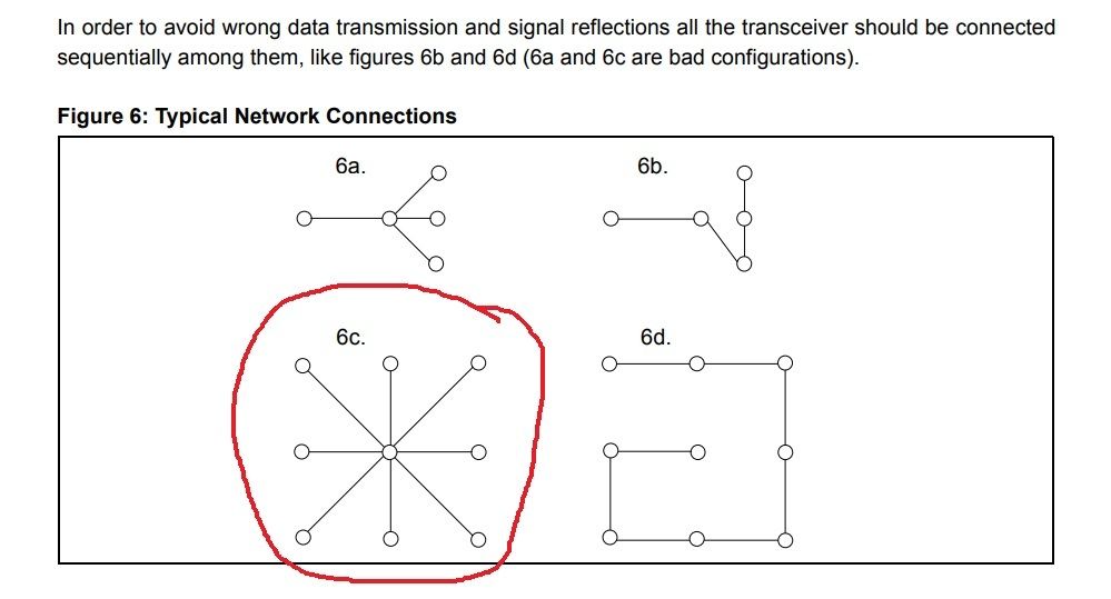

In one project we are using ST1480ABDR (Transceiver) and Baud rate is 115200.
One master and 19 Slave connected in star topology.
Please find attached reference termination resistor on both side, one at master and only one at slave.
Run time our communication disturb. we are using shielded non twisted cable for communication.

@vrajesh Have you thought about why in your picture "on board termination.png" fig. 6c = star topology is NOT recommended?
You wrote that you have a termination resistor on the master and only one on the slave. However, it is not clear whether:
Do you realise that you can't get any meaningful communication in either case?

@vrajesh wrote:One master and 19 Slave connected in star topology.
And you supplied this picture:
It tells you that the star arrangement is a bad configuration - so why do you do that?
Why are you surprised when it does, indeed, give you bad results?!
And why did you not use twisted pair - as every reference suggests you should?!
