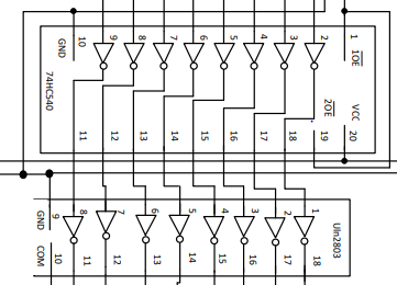

Thank you for your reply. Can you help me understand the diagram below?
Thank you in advance
Peter BENSCH
In your schematics, someone has drawn the stages of the ULN2803 as digital inverters. They can be interpreted as such under certain circumstances, but this is actually incorrect, as explained above. The ULN are not digital stages, but originally output drivers for loads that a normal digital output (TTL, CMOS, etc.) cannot drive directly: relays, power LEDs etc. I would choose a representation that shows at least one transistor per stage.
