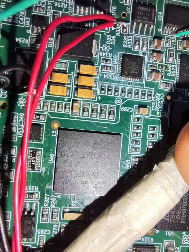

Are you sure that the STM32F439NI are not fakes, which usually do not show ID data or other information?

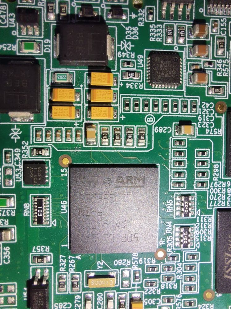

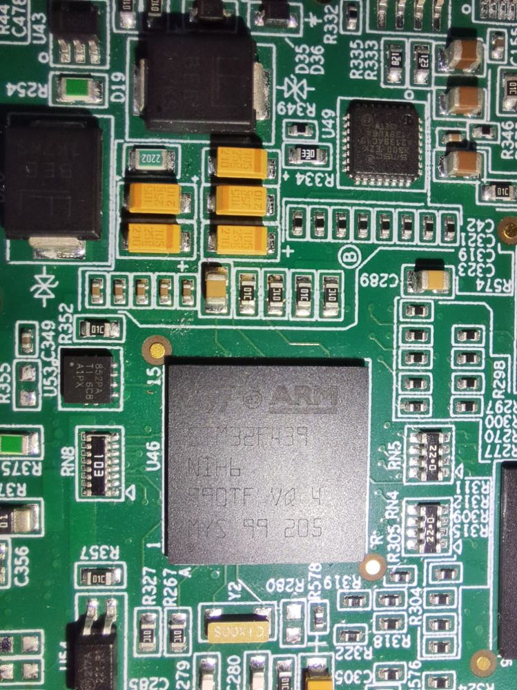

Show full markings of both these parts. Take a picture that is large, in-focus, clear and in circuit context.
Read the full Die / Part number (DEVID), memory size, and option bytes.
If the Flash Size and System Memory are filled with 0xFF these are likely fake or engineering samples.

Am Attaching the Photo of Mounted Micro Controller
