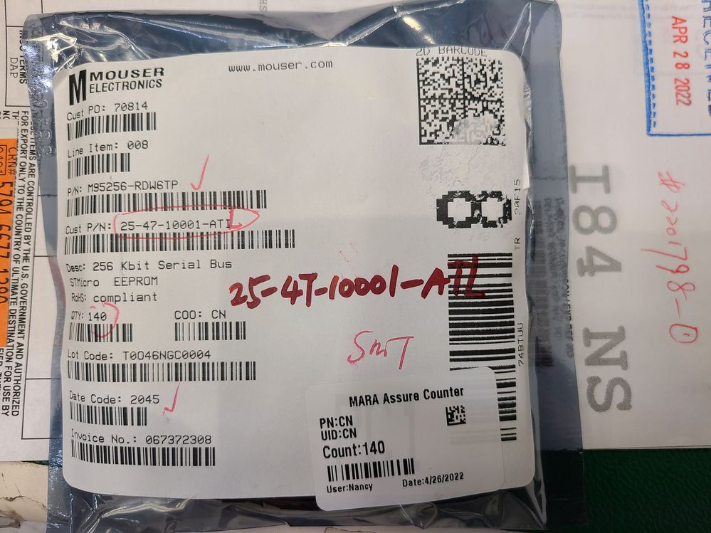

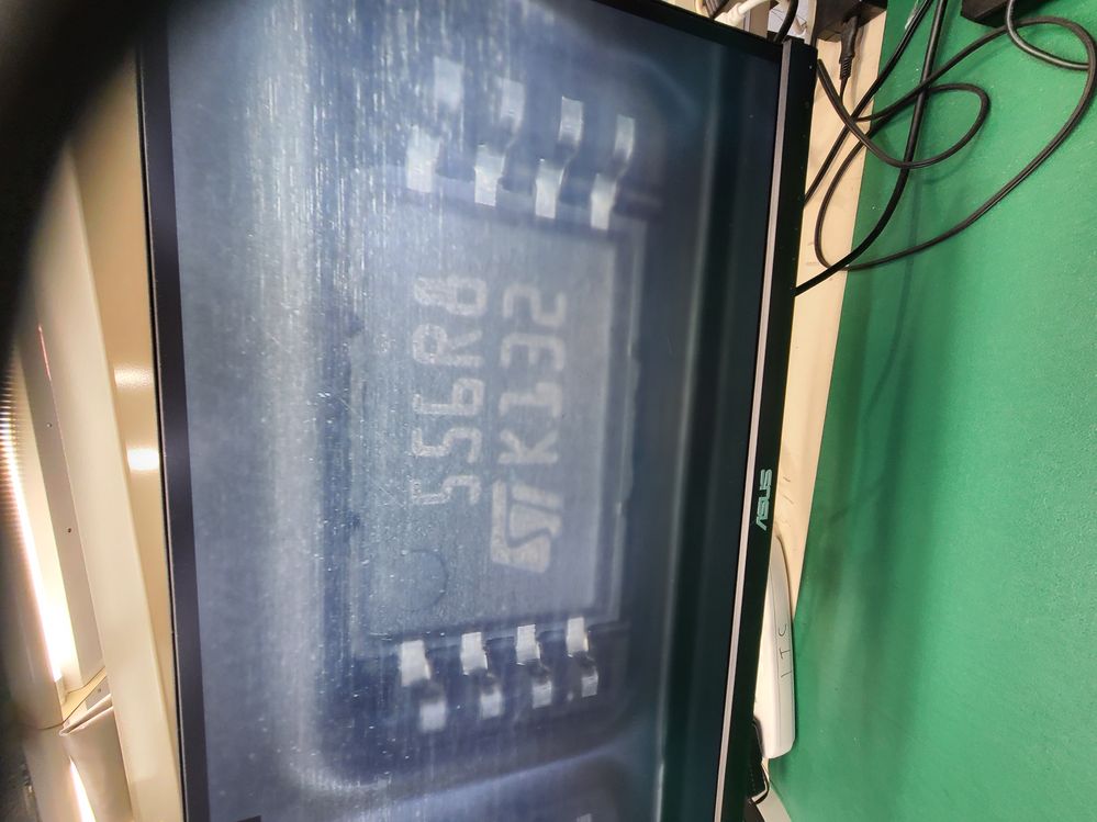

Date code K132 is from ST & means manufactured in 2021, week 32.
Data code 2045 is from Mouser. --> I think you should ask them what it corresponds.

Seems consistent, any other letters? The Marking details have been poorly handled by the docs and this needs improving.

2022-04-29 11:47 AM
i have attached images
