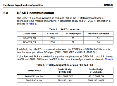

2024-03-25 12:12 AM
The answer to why PA4 and PA5 did not work is in the UM2364 manual in section 6.8 USART communication
(see figure below).

2024-03-25 12:12 AM
(see figure below).
